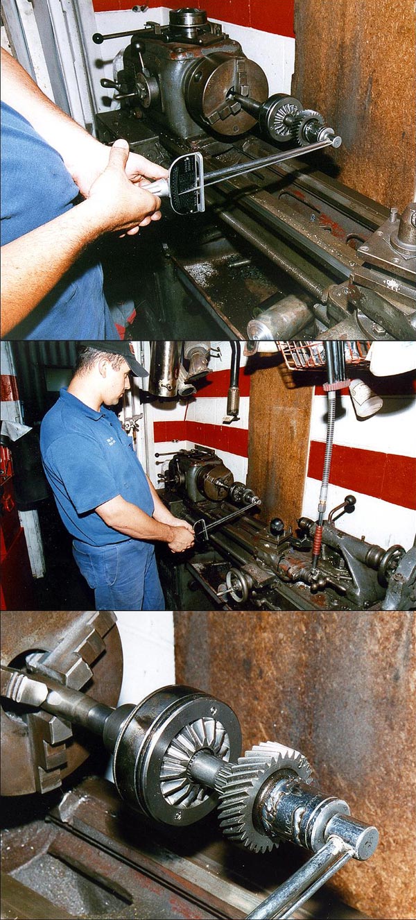

Testing
The first step in testing your existing viscous coupling is to remove it from the vehicle. Note that there's no need to drop the entire gearbox - the transfer case simply unbolts once the tailshaft and gearbox cross member are removed. The transfer casing is then split in two and the VC is pulled out.
There are major differences between those VCs found in vehicles built before and after the MY99/Version 5-6 STi. Earlier models have a circlip on the coupling, which - when removed - allows the housing to be split and the VC cartridge to come out and to be disassembled. Post MY99s - with their stronger, 6-bolt gearbox housing - have a sealed VC assembly that's impossible to open and repack. The viscous liquid in these couplings, incidentally, is said to be very tacky and smelly.
Once the viscous coupling is extracted from the rear transfer case, MRT can perform their unique lathe test. Torque is passed from the lathe's chuck through a makeshift "pinion shaft" and into the test VC cartridge. Measurement of the torque that passes through the VC cartridge is derived from a torque wrench that's connected at a right angles to cartridge and its output shaft. Notice that testing post-MY99 VCs (which cannot be opened) requires the use of various different lathe components. Spinning the whole assembly at 100 rpm, a typical Liberty RS/Impreza WRX VC should see around 10kg/m indicated on the torque wrench. If it comes up much less, the VC is considered worn out - something that's often caused by running unequally sized tyres on the car.

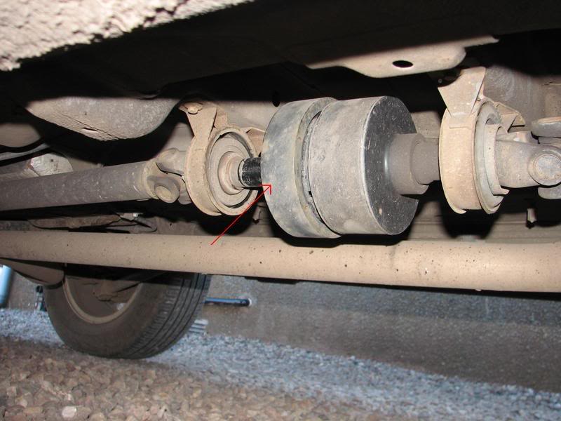

IMG_0032.jpg [ 63.87 KiB | Прегледано 6719 пъти ]
