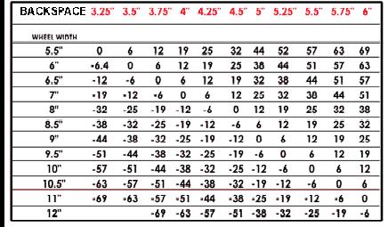

What is the difference between backspace and offset? How do I figure out what my backspace should be?
Wheel offset is the plus or minus measurement (in mm) from the center line of the wheel's width. Backspace is the measurement (in inches) from the mount surface of the wheel to the inside (or back) edge of the wheel, including the bead flange. Please refer to the following chart to convert wheel offset (black numbers) to backspace (red numbers) and vice versa.
ofset.JPG [ 34.88 KiB | Прегледано 356 пъти ]
Надявам се да съм бил полезен на някой :)
