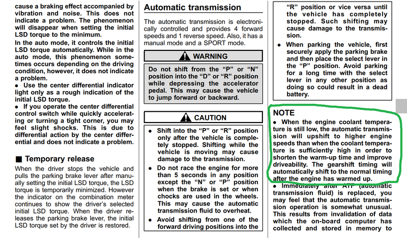

Това е от ръководството на Impreza, но предполагам е същото и за други с АТ.
Без име.png [ 350.24 KiB | Прегледано 583 пъти ]

ето и научното обяснение от Субару:
4. Engine Revving Higher When Cold
The optimal operating temperature for power output, fuel efficiency, and reduced emissions for Boxer Engines ranges from 84 °C to 100 °C.
The Catalytic Converter which is the main exhaust emissions control device also require a minimum temperature of 300 °C before it can operate efficiently.
The Engine Control Module (ECM) and Transmission Control Module (TCM) work together to bring the engine and catalytic converter up to operating temperature as quickly as possible by using a lower gear ratio to increase engine RPM.
The Climate Control Module also transmits the desired interior temperature to the ECM, which may also increase the engine RPM to meet customer demands.
Note: You may become concerned the engine is revving too high when cold based upon past experiences. The ECM is in constant control of this RPM and ensures it is suitable based upon temperature conditions.
