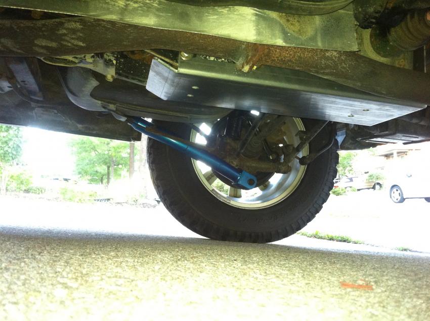

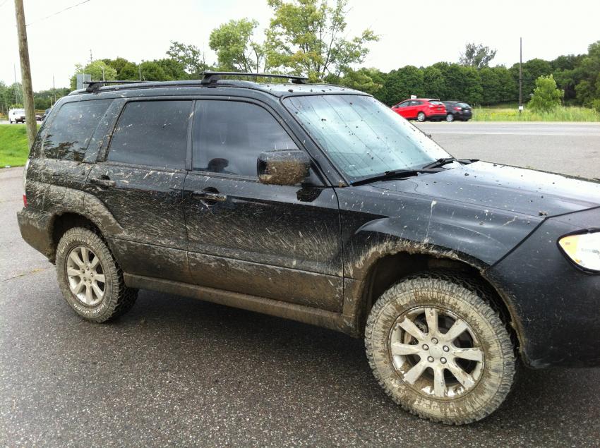

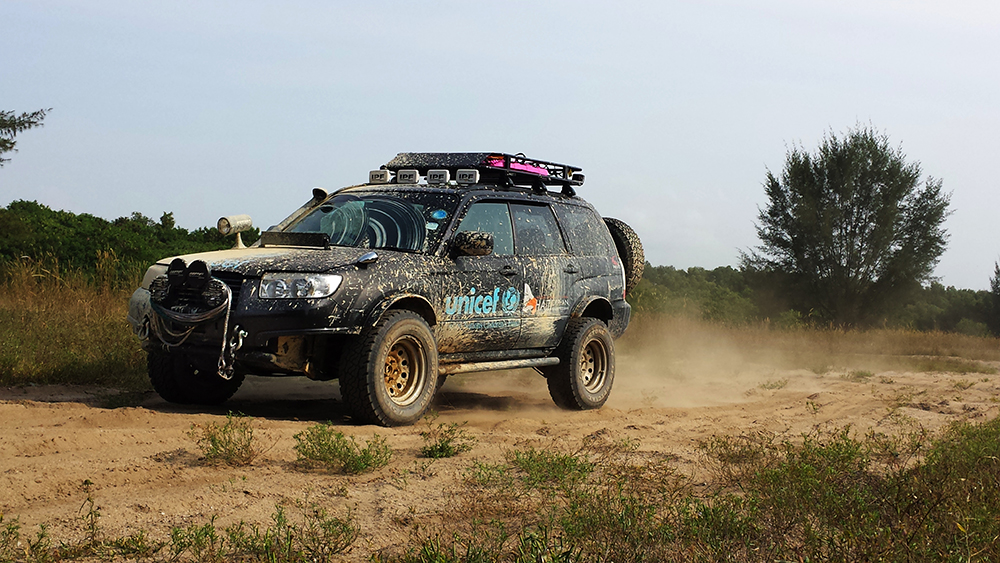

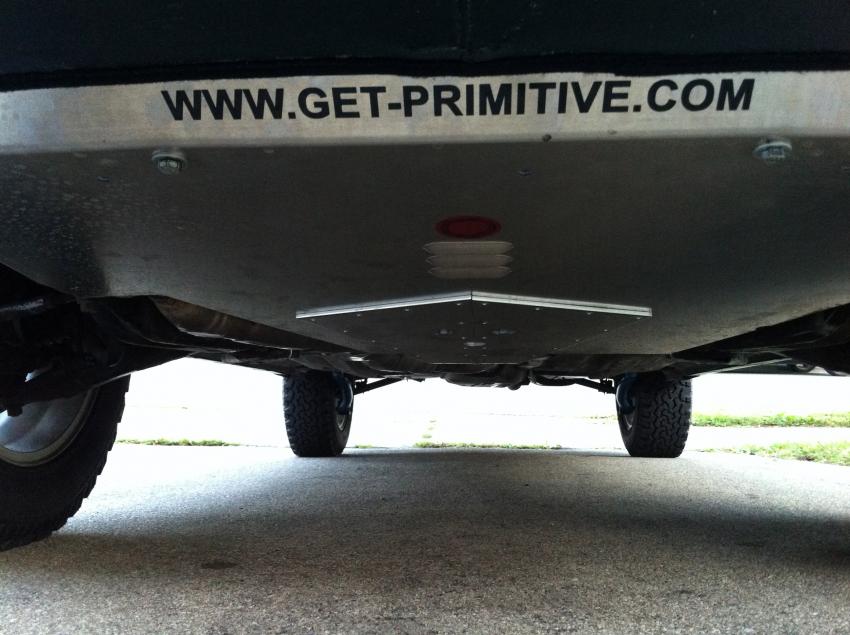

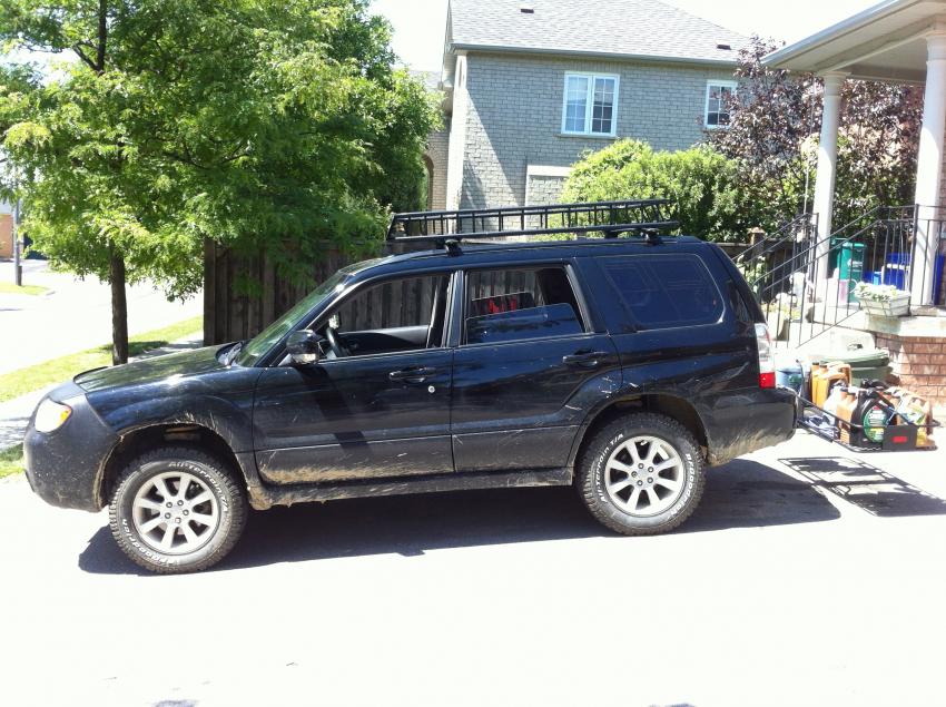

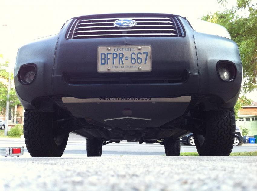

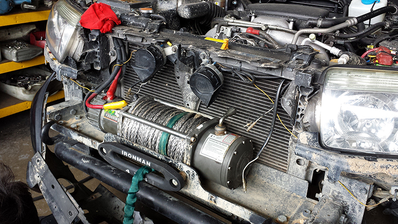

Здравейте! Отварям тази тема със снимки на най-якия форестър, който съм виждал и който поне лично на мен ми дава някои доста интересни идеи за модификации на моя Фори. Като за начало обмислям да сложа 5 см лифтинг кита, който се предлага от колега от форума ни.
Надявам се темата да е полезна и за други SUBARU Forester маниаци. Ето това е линк към оригиналния постинг: http://goo.gl/oxsFKQ
Oписание на модификациите, за съжаление нямам време да го преведа в момента, а и за съжаление някои термини (конкретни части) най-вероятно ще ги преведа неправилно ... ;)
ImHigh написа:
Hi All, what a great site. Many visits but first post. Had a busy day. My shipment from Primitive arrived this morning and I spent the day creating the Beast. Installed King Springs on KYB GR2's with Primitive 3/4" front and 1" rear lift spacers, 3/16" Primitive aluminum skid plate and diff cover. Added cam bolts front and rear. Much thanks to Paul and Ben at Primitive Enterprises, exceptional materials and build quality, excellent information and services a true first rate operation offering awesome products I Highly Recommend them. Pulled the factory trailing arms and replaced them with OBX adjustable trailing arms to centre the wheels. Had my tire guy install a fresh set of 215-70-16 BF Goodrich All Terrain TA KO's (wicked tires) then off to the suspension shop for a four wheel alignment. Took it to my Subaru dealer to check all of my work. Got a clean bill of health at no charge!! Previous mods include an Alpine INA W900 mounted in a JDM Navi hood where the dash pocket used to be. 7" Magellan GPS mounted in the stock radio opening. Kaption Audio 6.5" Pro Components in front doors (made a 1" spacer)and tweeters in stock locations, Kaption Audio 5.25 Pro Components in rear doors with tweeter installed in the knock out, Kaption Audio 12" Pro SPL MAX sub in custom enclosure in hatch, Kaption Audio 600 watt 4ch amp under drivers seat, Kaption Audio 1000 watt 1ch amp under passenger seat. Ram dash mounts for iPad & iPhone, 2 Alpine rear cameras 1 wide & 1 aimed at hitch ball,Viper 5902 with Smart Start and GPS tracking (speed,heading,location and status) for FULL control from iPhone including display of OBD2 scan codes,battery level, internal temp, status of ignition,engine,locks,doors,trunk,hood etc.. Remote start,locks,windows, sunroof etc... Sensor for tilt,proximity,shock and glass break. One touch up/down for all windows from d/s switches. Dash cam, 20% window tint and Weather Tech digital fit floor liners. Drawtite Class 2 hitch receiver,Prodigy P2 brake controller and 7 way trailer connector. Full length roof basket,hitch basket and bike rack all by Sport Rack. Custom made United Trailers 6x10 V-Nose enclosed trailer with electric brakes and low roof colour matched to car. More to come:brake upgrade, new cat back exhaust, Subtle Solutions hood struts, rad shroud and alternator cover a light bar with Hella Black Magics and perhaps an XT hood. Thanks for all the ideas.
IMG_0961.jpg [ 117.41 KiB | Прегледано 3282 пъти ]
IMG_0963.jpg [ 94.95 KiB | Прегледано 3282 пъти ]
IMG_0964.jpg [ 65.24 KiB | Прегледано 3282 пъти ]
IMG_0968.jpg [ 102.39 KiB | Прегледано 3282 пъти ]
IMG_0974.jpg [ 63.5 KiB | Прегледано 3282 пъти ]
IMG_0979.jpg [ 77.91 KiB | Прегледано 3282 пъти ]
IMG_0987.jpg [ 34.69 KiB | Прегледано 3282 пъти ]
IMG_0991.jpg [ 52.91 KiB | Прегледано 3282 пъти ]
IMG_0994.jpg [ 67.01 KiB | Прегледано 3282 пъти ]
IMG_0996.jpg [ 63.25 KiB | Прегледано 3282 пъти ]
Последна промяна lupo на Пон Яну 27, 2014 4:32 am, променена общо 2 пъти

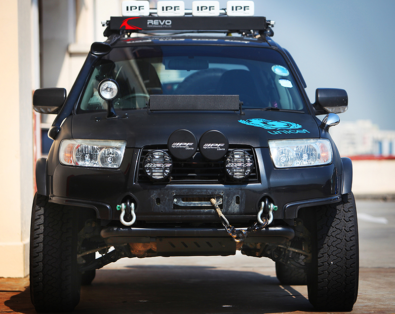

още малко снимки
IMG_0290.jpg [ 72.1 KiB | Прегледано 3281 пъти ]
IMG_0291.jpg [ 108.11 KiB | Прегледано 3281 пъти ]
IMG_0694.jpg [ 84.97 KiB | Прегледано 3281 пъти ]
IMG_0943.jpg [ 56.83 KiB | Прегледано 3281 пъти ]
IMG_0786.jpg [ 111.73 KiB | Прегледано 3281 пъти ]
IMG_0477.jpg [ 90.78 KiB | Прегледано 3281 пъти ]
IMG_1056.jpg [ 108.17 KiB | Прегледано 3281 пъти ]
IMG_1141.jpg [ 101.01 KiB | Прегледано 3281 пъти ]
IMG_1048.jpg [ 84.43 KiB | Прегледано 3281 пъти ]

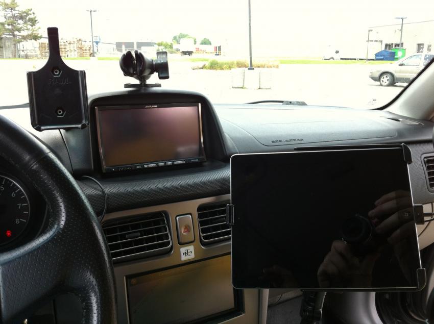

последни снимки
IMG_1145.jpg [ 113.17 KiB | Прегледано 3280 пъти ]
IMG_1065.jpg [ 65.23 KiB | Прегледано 3280 пъти ]
IMG_1060.jpg [ 87.09 KiB | Прегледано 3280 пъти ]

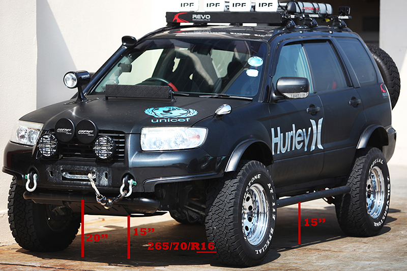

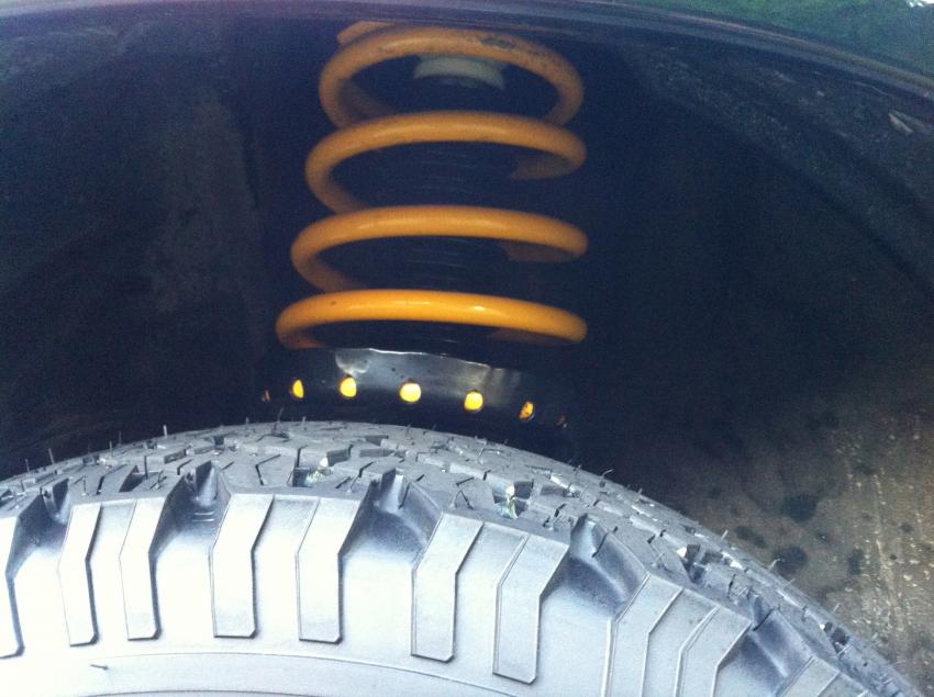

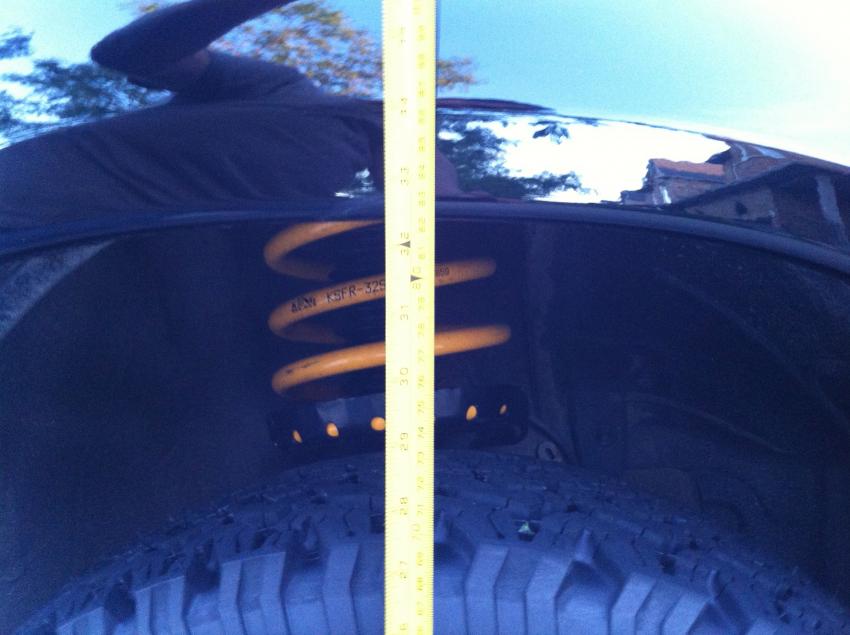

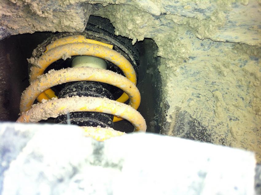

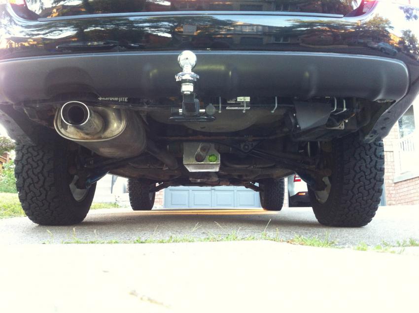

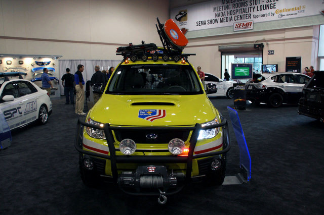

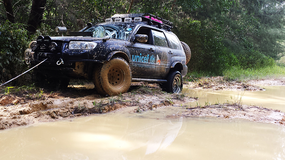

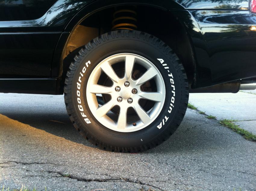

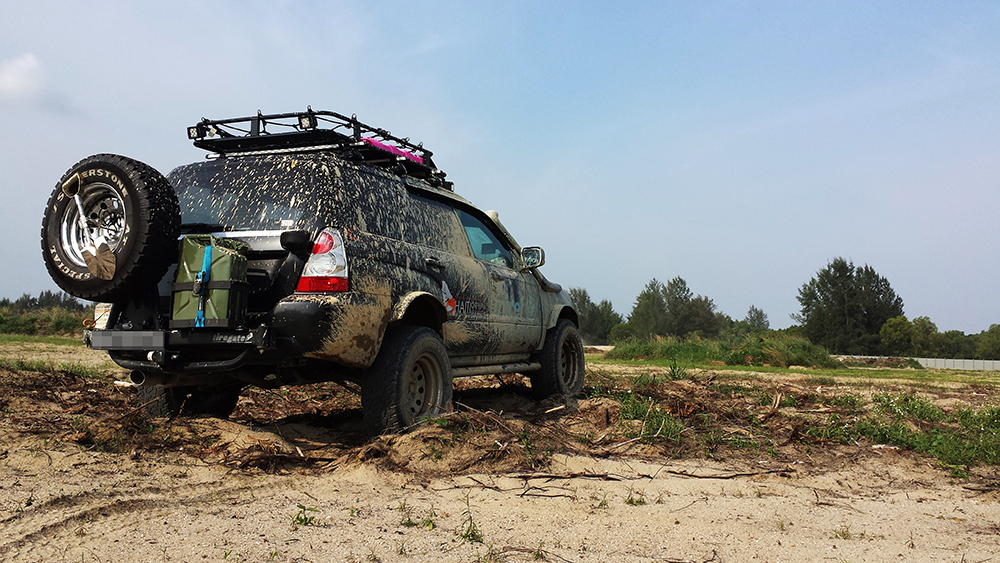

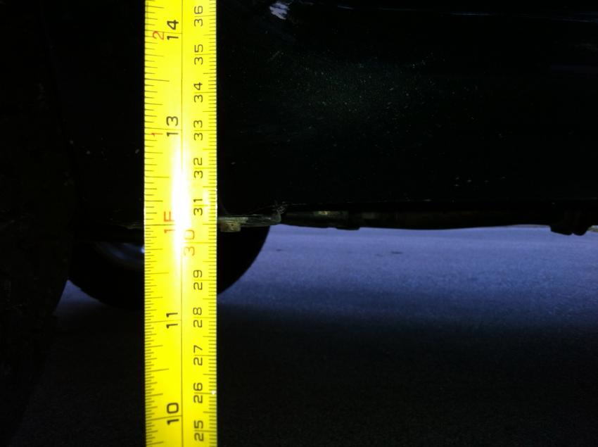

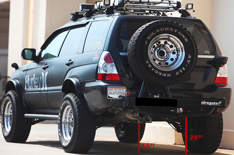

Снимки от един друг много як Форестър с клиренс 38.1 см (15 инча) ...
(обърнете внимание на местоположението на лопатката на снимка #6 ... #-o
001.jpg [ 431.84 KiB | Прегледано 2977 пъти ]
002.jpg [ 396.28 KiB | Прегледано 2977 пъти ]
003.jpg [ 451.43 KiB | Прегледано 2977 пъти ]
004.jpg [ 636.55 KiB | Прегледано 2977 пъти ]
005.jpg [ 577.35 KiB | Прегледано 2977 пъти ]
006.jpg [ 603.31 KiB | Прегледано 2977 пъти ]
007.jpg [ 453.68 KiB | Прегледано 2960 пъти ]

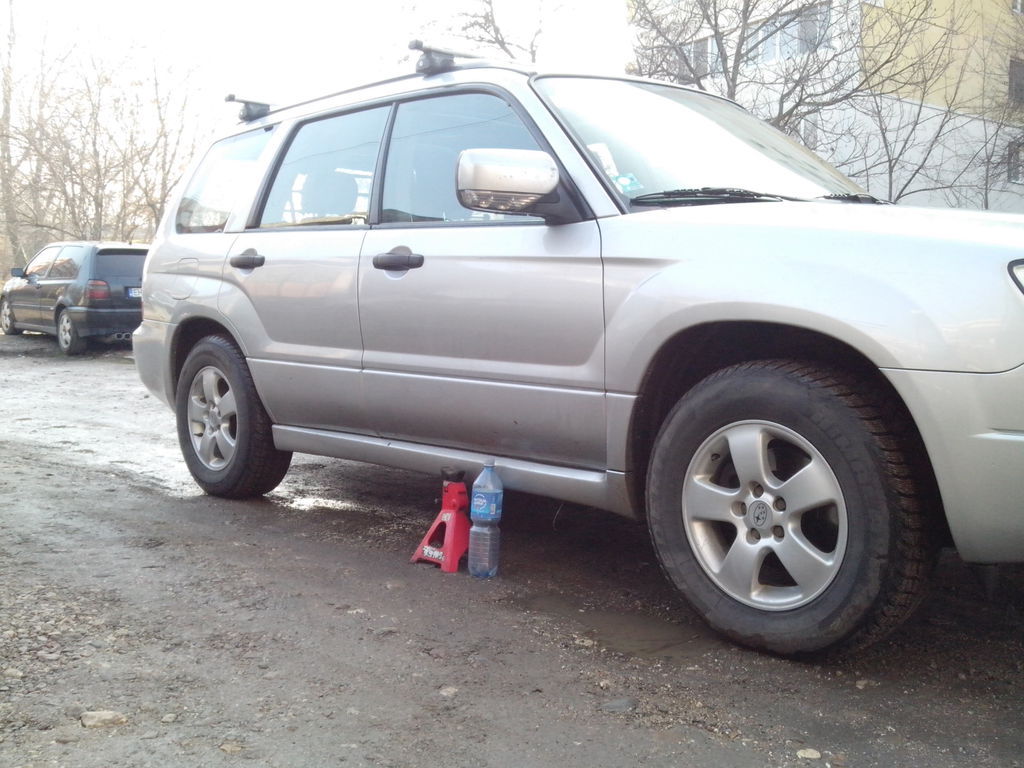

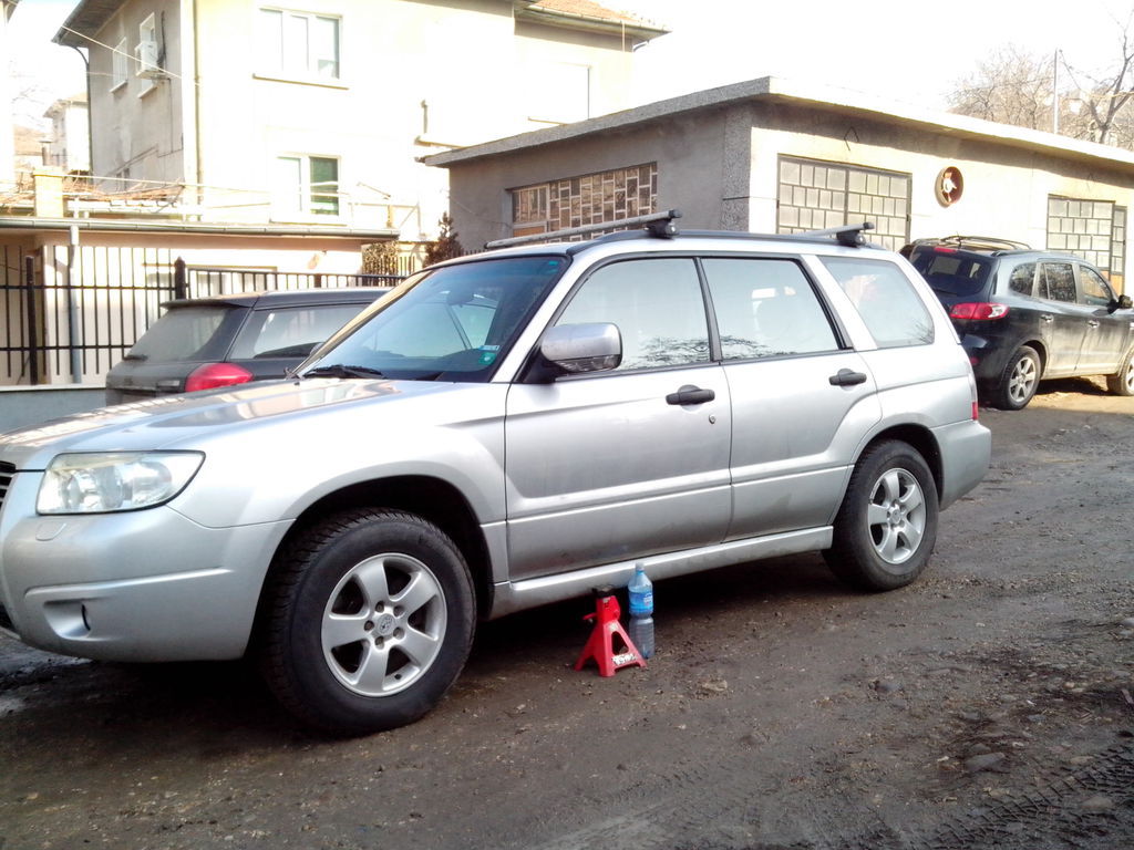

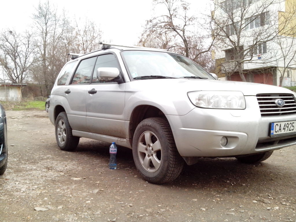

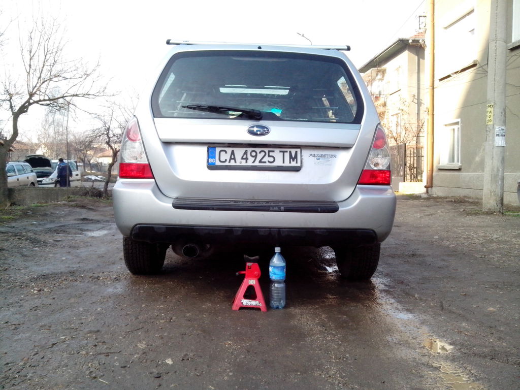

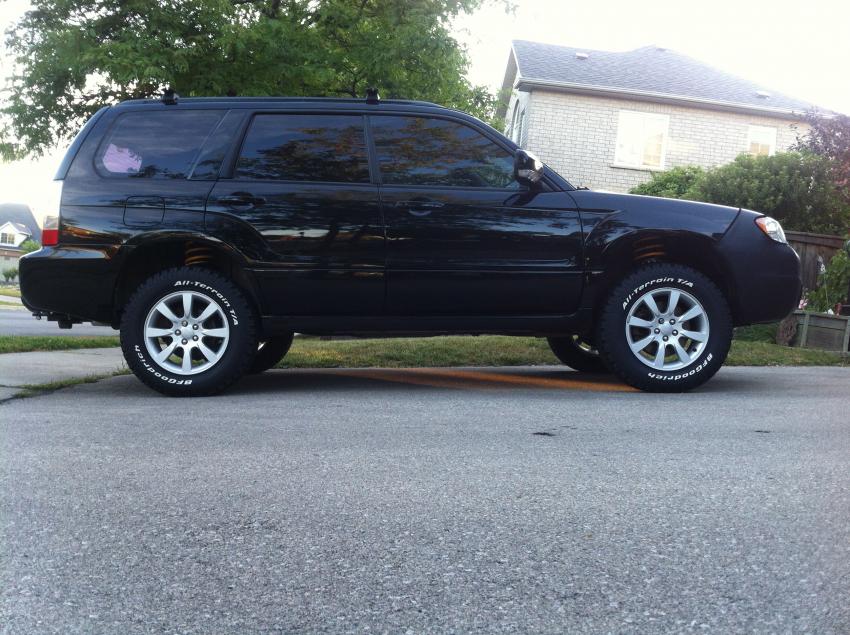

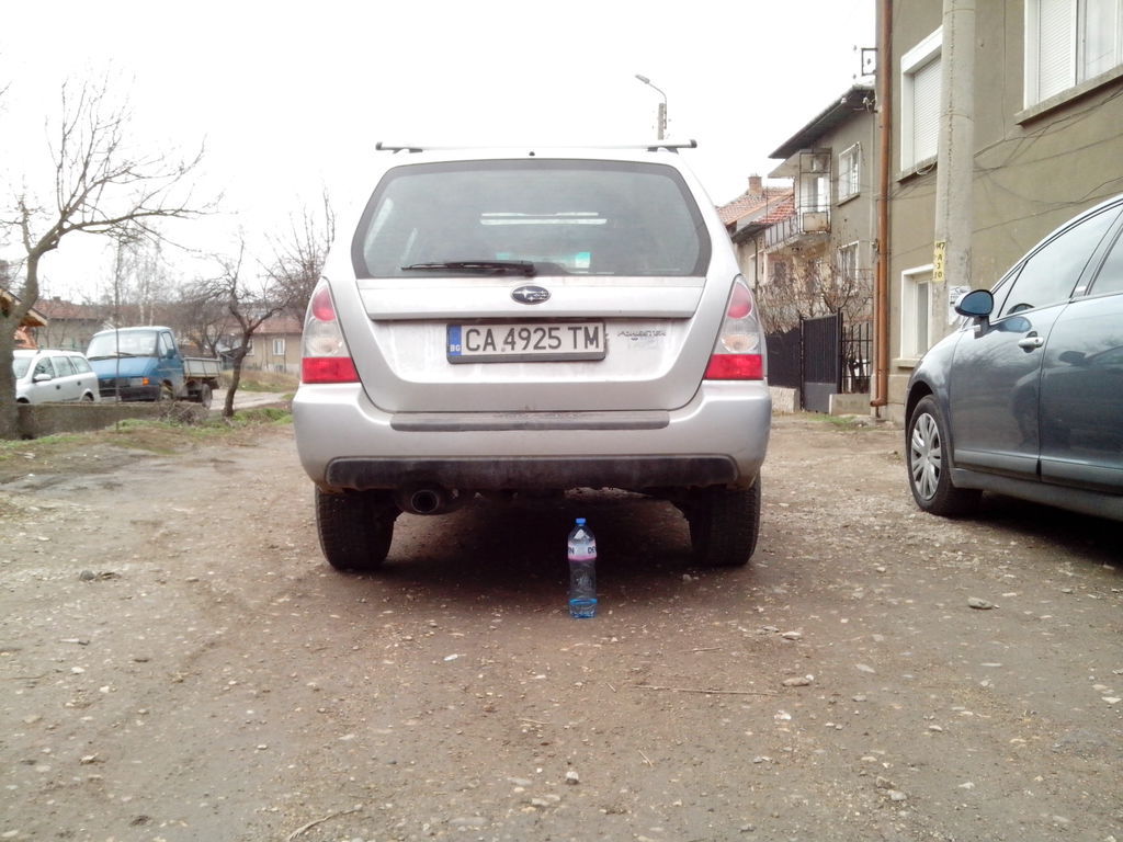

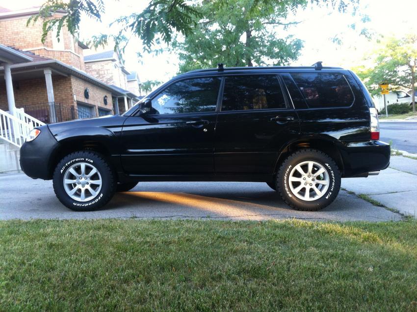

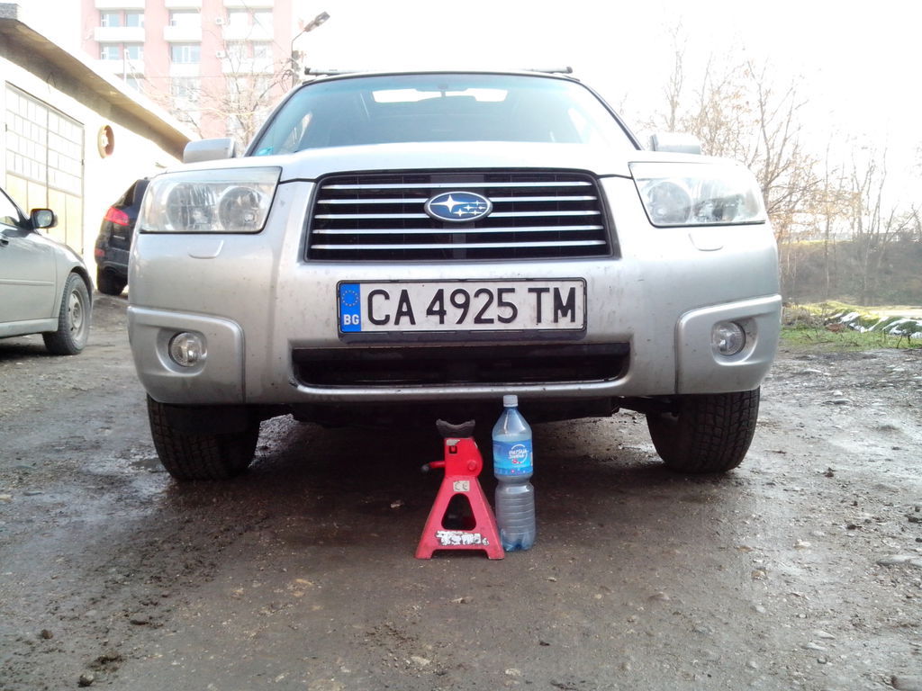

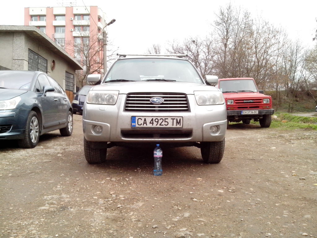

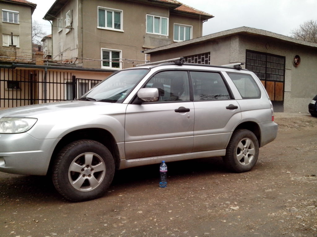

днес най-накрая приключих успешно първия етап от ъпгрейда на моето ФОРИ:
1. Поставяне на лифт кит за повдигане с 5 см.
Комплекта е купен от колегата тук. Казвам най-накрая, защото първоначално получих лифт кит за Аутбек, който по никакъв начин не можеше да пасне на предните ми амортисьори ... :)
Колегата sk67 много коректно изцяло за своя сметка го смени, но направата на новия комплект се нуждаеше от технологично време допълнително от около седмица.
През тези 10-тина дни общо докато успея да се вредя колегите от Субару сервиза в Плевен (Сервиза на Краси!) да монтират новия комплект се оказа, че съм изхвърлил бутилката, с която мерих на първите снимки. :(
Според мен тази първата бутилка от сръбска минерална вода беше малко по-височка от тази, с която мерих днес
Първи впечатления: ... разликата от комби до мини джипка (Mini SUV) е точно 5 см порастване на височина ... ;)
Колата е много стабилна в завои - не успях да констатирам някаква особена разлика. По пътя от Плевен до Ловеч има някои доста интересни завои, в които нарочно влизах доста по-бързо итн - всичко беше 100% ОК.
За момента НЕ съм сменявал биалетките, надявам се въпреки описания проблем с биалетките в темата за лифт кита да не се наложи. Ако ли не ... ще ги сменя с такива от Toyota .... (срам)! ... ;)
2. Ъпгрейд етапа поставяне на защита на задния диференциал го пропускам, защото колата ми дойде с поставена такава защита от Италия.
3. За следващия етап: поставяне на защита на картера ... не знам какво да правя :) Говорих с един доста опитен колега от форума, според който фабричния пластмасов предпазител под двигателя (под картера итн), който има в момента е от доста здрава пластмаса и според него няма нужда да се сменява освен ако не мисля да карам колата из особено екстремен терен - за сега нямам подобни планове ... но все пак се чудя и чета по чуждите субару форуми.
Ще съм много благодарен за помощ по темата надеждна ли е като защита на картера фабричната пластмасова кора под двигателя
Коментар на файл: ПРЕДИ
00-0.jpg [ 140.67 KiB | Прегледано 2209 пъти ]
Коментар на файл: СЛЕД
00-1.jpg [ 133.4 KiB | Прегледано 2209 пъти ]
11-1.jpg [ 138.52 KiB | Прегледано 2209 пъти ]
22-0.jpg [ 142.13 KiB | Прегледано 2209 пъти ]
22-1.jpg [ 165.32 KiB | Прегледано 2209 пъти ]
33-0.jpg [ 132.43 KiB | Прегледано 2209 пъти ]
33-1.jpg [ 171.25 KiB | Прегледано 2209 пъти ]

Много добре изглежда след лифта, но най-важно е теб да те кефи. Ако си любител на разходките извън пътя сега можеш да усетиш удоволствието от карането, дребни и по-едри камъни и коловози няма да са проблем.
Относно биалетките, желателно е да ги смениш със съответните по-дълги. Просто стабилизиращите щанги застават под друг ъгъл, особено голямо е напрежението в предните биалетки, затова и те най-често се късат.
За защитата на картера трябва да си поставиш такава от метал или дурал ако смяташ да ходиш в гората. Кората под двигателя просто го предпазва от вода и мръсотия и обезшумява. Само с тази кора при удър в камък нямаш шанс. Аз на мойто Фори съм изработил малка кора от дурал, която предпазва само картера и се поставя под пластмасовата. Така основната пази двигателя от мръсотия, а тази пази картера и основната.

Честито!
Изглежда много секси с това вирнато дупе!
Щом си направил първата крачка, вече няма спиране... ;)
