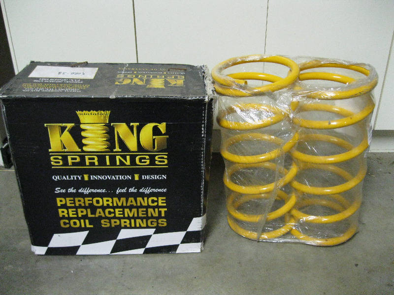

Това е тежката артилерия +30 mm ;) , в комбина с KYB
KINGS (raised)
Are apparently about 25% stiffer than originals (front 148lb, rear 140lb)
front (KSFR-32) 185lb
rear (KSRR-33) 175lb за SF5 , за SG модели KSRR-43
Guarantee - if sags more than 10mm then free replacement..
Dobinsons - Much stiffer on the specs, and was told that they are linear rate.
front (25mm raise C55-044) 250lb
rear (30mm raise C55-045) 215lb
http://offroadsubarus.com/showthread.php?t=3107&page=3
KSRR33.jpeg [ 85.9 KiB | Прегледано 4442 пъти ]
