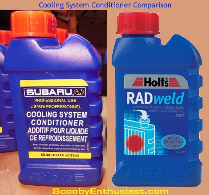

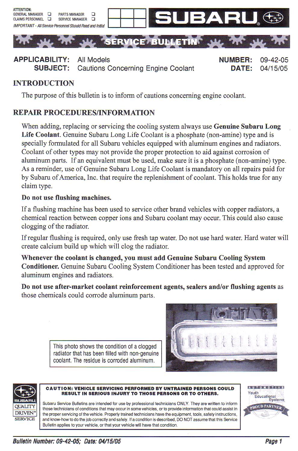

BrainStormeR написа:
2. И аз се интересувам от такава добавка/антифриз с добавката.
Ето това е сервизният бюлетин и въпросната добавката към антифриза.
TSB 09-42-05.jpg [ 297.42 KiB | Прегледано 26777 пъти ]
SUBARU-cooling-system-conditioner-bottle-SOA635071-comparison-to-Holts-Radweld2-md.jpg
SUBARU-cooling-system-conditioner-bottle-SOA635071-comparison-to-Holts-Radweld2-md.jpg [ 78.07 KiB | Прегледано 26777 пъти ]
В чуждите форуми се говори, че двете добавки са еднакви, а и производителят е един и същ "Holts".
Българските дилъри май не са и чували за такава добавка и не я предлагат, не предлагат също и оригинален антифриз - странна работа.

MODEL: ALL DESCRIPTION: Subaru Cooling System Conditioner (Case Quantity) Part # SOA345001
Note :Subaru Cooling System Conditioner is packaged in cases that contain 12 bottles. Each affected vehicle requires one (1) bottle. Each case contains enough material to treat 12 vehicles.
Prior to the release of this Service Program, each dealer will automatically be shipped a quantity of Subaru Cooling System Conditioner equivalent to 40% of their vehicle sales, or up to a maximum of 20 cases.
Additional quantities of the Cooling System Conditioner will be available through normal parts channels after 2/15/04. In order to maintain an adequate part supply, SOA requests that Dealers only order quantities necessary to satisfy anticipated demand.
REPAIR PROCEDURES
The repair procedure involves adding Subaru Cooling System Conditioner to the cooling system. Follow the recommended procedure that applies to either a "Cold" or "Hot" engine.
Caution :The engine cooling system is under pressure and may he extremely hot. To prevent personal injury or vehicle damage he sure to take appropriate precautions while performing this procedure.
Service Procedure on a COLD Engine
1. Install rags around the radiator filler neck to prevent coolant from contaminating the engine area.
2. Take off the radiator cap and set aside.
3. Extract 125ml (4.23 oz.) of coolant from the radiator using a suitable device such as a piston syringe, meat or poultry baster, antifreeze hydrometer, etc.
4. Place the syringe into the overflow reservoir and push the coolant out of the syringe.
5. Shake the bottle of cooling system conditioner until all contents are thoroughly mixed.
6. Pour the entire bottle of cooling system conditioner into the radiator.
NOTE : Do NOT pour the cooling system conditioner into the overflow reservoir. The conditioner Will settle at the bottom of the reservoir and not mix in the cooling system.
7. Reinstall the original radiator cap.
8. Remove rags from around the radiator filler neck.
9. Start the vehicle and let it run until the engine is warm. This ensures the conditioner circulates and there are no air pockets in the cooling system.
